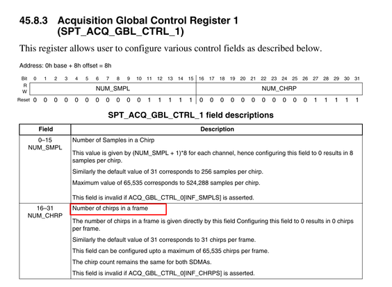

你好,我在使用S32R274开发雷达相关的东西,请问我SPT代码怎么修改,我需要改32chirp到8chirp

I do not know what kind of drivers you use to run the application.
Is it RSDK or your own?
If it is RSDK please refer to RSDK reference manual:
In case you have custom driver then the chirps are configured in SPT_ACQ_GBL_CTRL_1 register:
Peter

         我用的是官方的SDK,你说的是s32R274对应的配置,但是SPT相应的内核代码怎么修改呢

I am not able to help here as I do not know the upper layers. Maybe someone else is able to guide you.
Best would be simple go trough the documentation of drivers. In RSDK manual as I have posted.
