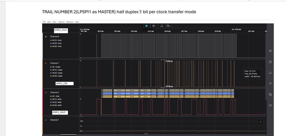

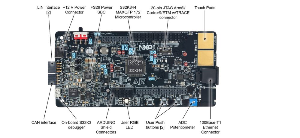

I want to bring up SPI interface on K344 Q172 EVK and Run a SPI Loop Back application but on S32DS, Example SPI Loop back Application given for these boards :
Hardware installation
Supported boards
S32K3X4EVB-Q257 47827 PCB RevX1 SCH RevA or S32K3X4EVB-T172 53148 PCB RevX5 SCH RevB

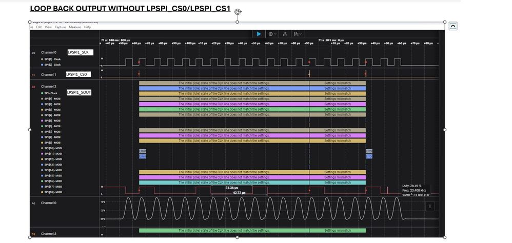

Since, I'm using Q172 K344 EVK, So I created Pin Mux for Q172 K344 EVK and performed Debug flash and probed signals for SPI master and slave. what I have observed is that chip select behavior is as not as expected and I have given screen shot of SPI Master signals and also there is no signals present on SPI slave. Please let me know If you need any further information to resolve this?
I'm attaching the project folder in zip and Logic analyzer signals screen shots.
Thank you.

Hi, @VaneB
Yes. the RxSlaveBuffer contains the same data that was transmitted by the master.

Hi @krishna_Bugudi
Since the data received by the slave is correct, it seems the issue is indeed related to the logic analyzer.

VaneB
Hi @krishna_Bugudi
Since we observed unusual behavior in the signal using the analyzer, the best way to ensure the data was transmitted correctly is to verify the information stored in the buffers.

Hi @krishna_Bugudi
I will test it on my side, but could you please help verify whether the RxSlaveBuffer contains the same data that was transmitted by the master? I would like to first rule out any issues with the logic analyzer, especially since the project configuration appears to be correct and is based on the original example code.
