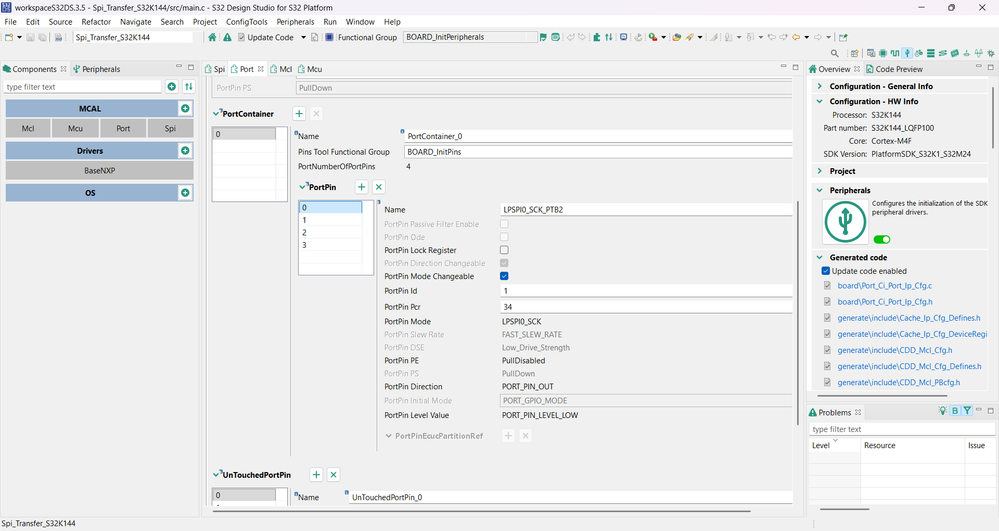

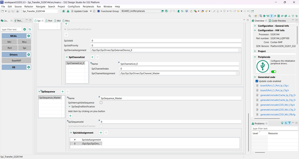

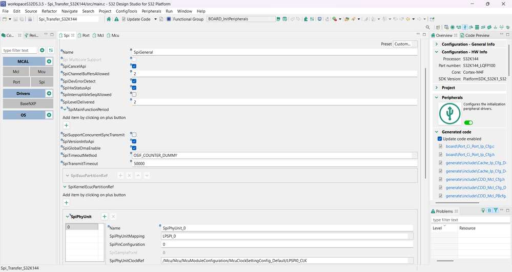

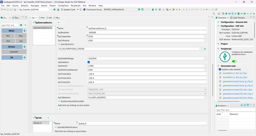

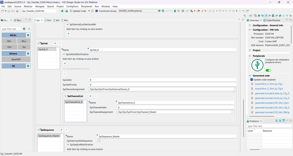

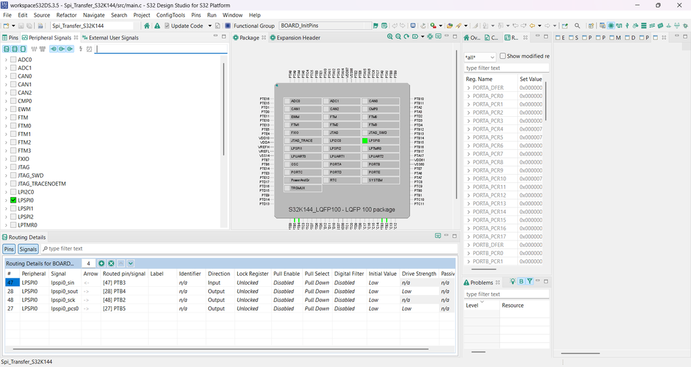

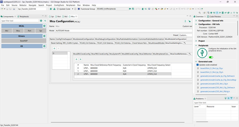

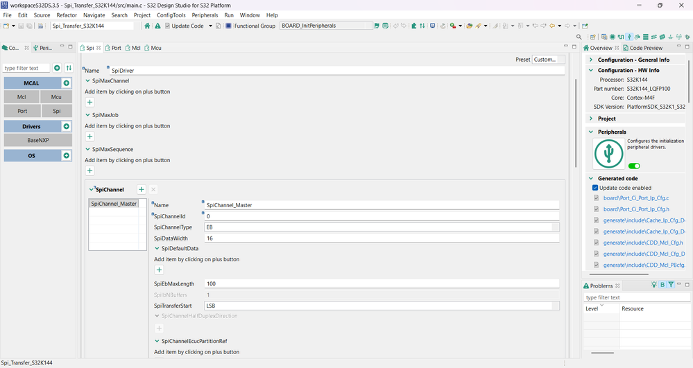

Hii,
  I am using s32K144 EVAL board and I am unable to understand the SPI config and map them, can anybody help me to understand how to map the SPI in S23 IDE, I have been trying to do it from past 3 days and this is so far i have got. My task is simple to perform communication between slave and master.
Pin mappingPin mappingClock settingClock settingSpi config_Pic1Spi config_Pic1Spi config_Pic2Spi config_Pic2Spi config_Pic3Spi config_Pic3Spi config_Pic4Spi config_Pic4Spi config_Pic5Spi config_Pic5Spi config_Pic6Spi config_Pic6Spi config_Pic7Spi config_Pic7

Did you read the description.txt of S32K1 RTD example Spi_Transfer_S32K144?
Please also read:
RTD_SPI_UM.pdf
RTD_SPI_IM.pdf
C:\NXP\S32DS.3.6.0\S32DS\software\PlatformSDK_S32K1_S32M24\RTD\Spi_TS_T40D2M30I0R0\doc
