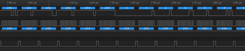

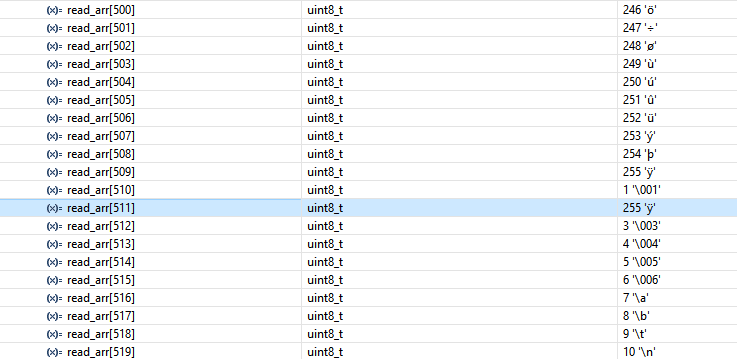

I am trying to use DMA LPSPI to write to a SD card. The DMA SPI was supposed to send 512 bytes in one major loop. The major loop has 512 minor loops and each minor loop transfer 1 byte.

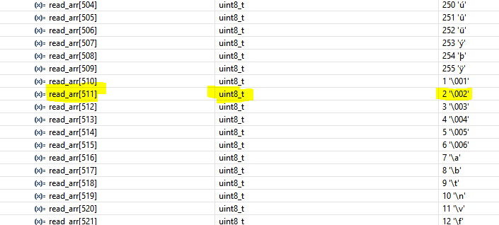

Here is my problem. I wanted to maximize my throughput that's why I set my SPI TX watermark to 3. But when I set it to 3, somehow my last byte (byte number 511) was not sent. It is oddly replaced with a random 0xFF byte. However, If I set the TX watermark to 1,2 or 4, it would work perfectly. However, I feel like setting a TX water mark of 4 will cause problems and 2 is not really efficient (the TX fifo has a size of 4). I have attached the picture of the array I get from reading the data back from the SD card. I know for sure that my read function is not the source of problem.
I'm using the S32K148evb-q176.

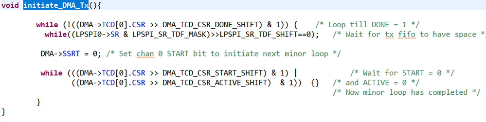

Here is the code to initiate the DMA using start bit
void initiate_DMA_Tx(){
while (!((DMA->TCD[0].CSR >> DMA_TCD_CSR_DONE_SHIFT) & 1)) { /* Loop till DONE = 1 */
while((LPSPI0->SR & LPSPI_SR_TDF_MASK)>>LPSPI_SR_TDF_SHIFT==0); /* Wait for tx fifo to have space */
DMA->SSRT = 0; /* Set chan 0 START bit to initiate next minor loop */
while (((DMA->TCD[0].CSR >> DMA_TCD_CSR_START_SHIFT) & 1) | /* Wait for START = 0 */
((DMA->TCD[0].CSR >> DMA_TCD_CSR_ACTIVE_SHIFT) & 1)) {} /* and ACTIVE = 0 */
/* Now minor loop has completed */
When TX Watermark is 1,2,4
When TX Watermark is 3

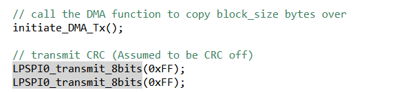

Thank you for your response. I have attached my code. Though my code is expected to get a response from the SD card therefore it might need some modifications to the code on your end to run it. I also scoped the SPI and the error also shows on the scope.
I noticed just now that if I run the whole thing without any breakpoints, it will show the wrong SPI data as mentioned. But if I put breakpoints before and after the initiate_DMA_Tx() (line 254 in SD_Module.c), it will run properly and sends the right data. So I am suspecting that this is a timing issue. I have tried to add the "wait for SPI transfer complete" while((LPSPI0->SR & LPSPI_SR_TCF_MASK)>>LPSPI_SR_TCF_SHIFT==0); after the initiate_DMA_Tx() but this will only solve for the first initiate_DMA_Tx() call (meaning 511th bit will be corrected, though 1023th bit, 1535th bit, 2047th bit will still be 255). Do you know why this is the problem?

You send 0xFF at the end of the 512-frame transfer, and the code that you sent does not wait until the SPI transfer is complete. At the time the DMA transfer ends the SPI is still working.
The fact that it works with the TCF flag only for the first time got me thinking that you probably don't clear the TCF flag.

That makes sense. Though I was wrong before, It actually behaves even stranger. It works only on the 1st time, 3rd time, 5th time and wouldn't work on any even calls. This happens when I check the TCF flag after calling the initiate_DMA_Tx() or after it finished the 512th minor loop (checking TCF within the initiate_DMA_Tx() function). I then tried to check TCF flag at the 511th minor loop and 512th minor loop and it works.
uint16_t count=0;
count++;
if(count>=511){
while((LPSPI0->SR & LPSPI_SR_TCF_MASK)>>LPSPI_SR_TCF_SHIFT==0); /* Wait for Transfer to be complete*/
LPSPI0->SR |= LPSPI_SR_TCF_MASK; /* Clear TCF flag */
It was probably the delay time of the if statement + checking it that allows it to slow down and finishes the final transfers. It doesn't seem to be the best way to do it but it works for now. Let me know if you know why it only works for odds calls and if there is a better way to check for the complete transfer. Thanks very much for your help!
