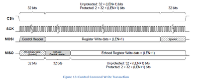

I am implementing SPI communication between the S32K314 MCU and MAC-PHY (LAN8651).
For Control Transaction Read (where the master reads a register value from the slave), the process follows the OA TC6 SPI protocol as shown in the image below:
The S32K314 MCU has a maximum SPI frame width of 64 bits. However, in some transactions, the required frame length exceeds 64 bits.
For example, as shown in the image below, when performing a Protected Write, the frame consists of:
  • Control Header (32 bits)
  • Protected Write Data (64 bits)
  • Total: 96 bits
After measuring the waveform, I noticed that if the SPI frame exceeds the configured bit width in the LPSPI Configurator, the SCK clock stops and then resumes for the remaining bits.

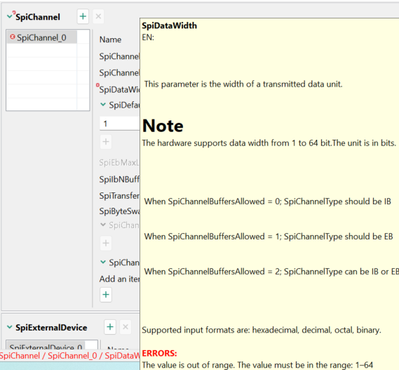

Your understanding of the frame size is correct, however the frame size is limited by hardware as shown in the image below. Therefore, it is not possible to transmit an only frame of 96 bits.
Also, the registers in continuous transfer mode are also limited by the maximum frame size as mentioned in chapter 70 of the S32K3XX Reference Manual Rev. 9 (registers CONT, CONTC).
Please let me know if this information was helpful.

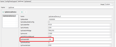

malove
Hello, @RomanVR
Thank you once again for your kind response.
I understood your answer as "It is not possible to specify a Frame Size exceeding 64 bits."

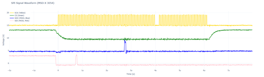

However, as shown in the image below, enabling the "SPI Enable Large Frame Size" function allows the generation of a Frame Size exceeding 64 bits.
- From top to bottom: SCK, CS, MISO, MOSI.

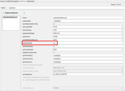

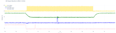

If the Frame Size is set to 64 bits, the output appears as follows:
In this case, 64 bits are output, and a gap occurs in between. This seems slightly different from what you described. How should I interpret this?

RomanVR
Hello @malove
I apologize for the confusion, I assumed that you were using SPI with MCAL layer, but with IP you can configure a transmission for a data width > 64 bits just as you have shown for the 128 bit transmission.
About the gap you are observing in the clock signal when configuring the frame size of 64 bits, I assume you are transmitting more than 64 bits. If that’s the case the gap is caused because of the differences between the frame size and the data size. Since you are transmitting more information, once the first frame is sent, a second transmission for the remaining bytes is initiated; as a second frame is sent, the SCK goes low before being active again.
