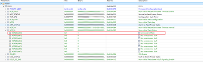

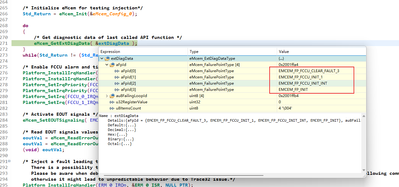

I am using S32K344 to run SPD demo V1.0.4. I found that the first calling eMcem_Init fuction always fail, what's the problem? It seems that Could not acquire exclusiveaccess to FCCU.WeiC_0-1721811369865.png

Hello @WeiC,
the diagnostic info implies that there is some FCCU fault pending before eMcem init and it's not possible to clear the fault. Therefore, it's some permanent fault where we need to find the root cause (might be wrong HW setup, lockstep error etc.).
Please could you share screenshot with FCCU status registers - NCF_S[].
Also please try to investigate when the fault occurred, if it's right in the beginning of startup after reset, or after some memory init in the startup, after some RTD init function etc.

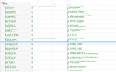

WeiC
before and after:
4,010件の閲覧回数
RadoslavB
OK, so it's Lockstep error, for specific root cause please share also DCMROD3, DCMROD4 and DCMROD8 register values.
