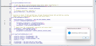

I'm trying to install s32k358_hse_fw_1.14.0_2.40.0_pb230807.bin.pink but i got this below errror when checking "FW install status"
Note: I've install success on this target before. But my colleague did something then FW was lost and we were trying to reinstall than this error happen.
Can you help to give me all reason that cause this failure which can help me to check?
Any tool or script which can help to recover and fix this issue?
I read some post on NXP community but found nothing?

lukaszadrapa
Hi @phuong_nguyenle
If the HSE firmware was erased by SBAF due to some fatal error, the only option to install the firmware again is a method via MU. It is mentioned here in the HSE FW RM:
HSE DEMOAPP uses only installation via IVT method, so it cannot be used.
So, take a look at section "3.3.1 MU Installation steps by host in AB_SWAP configuration" in the HSE FW RM. This describes the steps you need to follow. It can be done quite easily by debugger, it's just a few writes to registers. The timeouts are long enough.
Lukas
