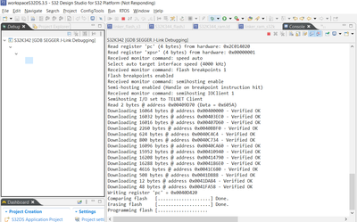

When I try to debug my program it flashes properly, but then it puts itself into sram and never leaves.
Reading common registers: Read register 'r0' (4 bytes) from hardware: 0x00000000
Read register 'r1' (4 bytes) from hardware: 0x00000000
Read register 'r2' (4 bytes) from hardware: 0x00000000
Read register 'r3' (4 bytes) from hardware: 0x00000000
Read register 'r4' (4 bytes) from hardware: 0x00000000
Read register 'r5' (4 bytes) from hardware: 0x00000000
Read register 'r6' (4 bytes) from hardware: 0x00000000
Read register 'r7' (4 bytes) from hardware: 0x00000000
Read register 'r8' (4 bytes) from hardware: 0x00000000
Read register 'r9' (4 bytes) from hardware: 0x00000000
Read register 'r10' (4 bytes) from hardware: 0x00000000
Read register 'r11' (4 bytes) from hardware: 0x00000000
Read register 'r12' (4 bytes) from hardware: 0x00000000
Read register 'sp' (4 bytes) from hardware: 0x00024020
Read register 'lr' (4 bytes) from hardware: 0xFFFFFFFF
Read register 'pc' (4 bytes) from hardware: 0x2C014020
Read register 'xpsr' (4 bytes) from hardware: 0x00000001
Setting breakpoint @ address 0x004033BA, Kind = 2, Type = THUMB, BPHandle = 0x0001
Starting target CPU...
Debugger requested to halt target...
...Target halted (PC = 0x2040012E)
Read register 'pc' (4 bytes) from hardware: 0x2E014020
Removing breakpoint @ address 0x004033BA, Size = 2
Read 4 bytes @ address 0x2040012E (Data = 0xFFFFE7FD)
Read 2 bytes @ address 0x2040012E (Data = 0xE7FD)
Reading 64 bytes @ address 0x00000000
WARNING: Failed to read memory @ address 0x00000000

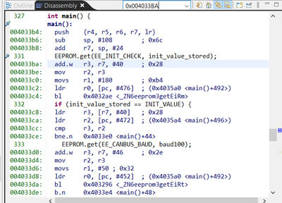

I can see that it has the breakpoint for the start of main, but instead the pc points to a random location in sram where the global variables are.
"Removing breakpoint @ address 0x004033BA, Size = 2"
but the line immediately after itin the console is
Read 4 bytes @ address 0x2040012E (Data = 0xFFFFE7FD) which is just sram data
Does anyone know what might cause this?
