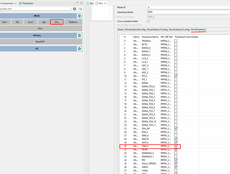

Ok, but once you configure clock you also have to enable it to the peripheral.
Did you enabled it in ME module for STM0 and 1?
It is in MCU plugin:
I have tested it here and everything is running as expected:
Attached is the example file if you like to test it
Peter

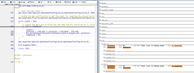

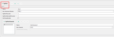

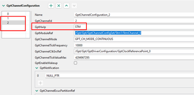

petervlna
Example code usually implement only basic demo features to show the functionality.
I wonder "S32K314 also supports STM_1, but why is there no clock configuration for STM_1 in the example code?"
I have just open the example for GPT and simply added STM0 and 1 modules and everything works as expected. Both are supported.
Simply follow the example or screenshot above and add STM1.
