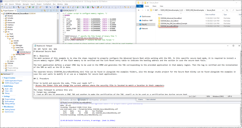

 I am using S32k3 HSE example demo code and using S32k3 hse advance boot secure code.
I am building this code with S32 Design studio but getting one error below:
make: *** [makefile:58: S32K344_Advanced_SecureBoot.elf] Error 1
Can you help me to solve it? Please find the screenshot.

Robin_Shen
Prior to build and execute the code, **the user needs to** :
- Access the linker file and change the current address where the security file is located to match a location in their computers.
Did you build S32K344_SecureBootBlinky project first and change the address of S32K344_SecureBootBlink.bin? (C:\NXP\S32K3_HSE_DemoExamples_1_0_0\S32K3_HSE_DemoExamples\Secure_Boot\S32K344_SecureBootBlinky)
Access the linker file and change the current address where the security file is located to match a location in their computers.pngAccess the linker file and change the current address where the security file is located to match a location in their computers.png

Robin_Shen
Please see S32K344_Advanced_SecureBoot/src/target/m7/S32DS/Linker_Files/standard/S32K344_flash.ld:
S32K344_SecureBootBlinky.bin AppBL.pngS32K344_SecureBootBlinky.bin AppBL.png
