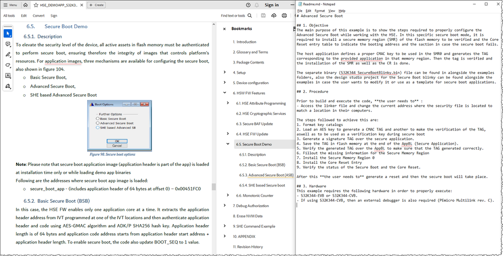

7,557件の閲覧回数
Robin_Shen
Sorry I may not understand your question. Please correct me if there is something wrong with my answer.
1. Does this binary file blinky will also be flashed in the mcu?
Yes.
2. Is this blincky file behave as bootloader file for this firmware?
S32K344_SecureBootBlinky.bin is the application image in flash memory that need to be authenticated to perform secure boot.

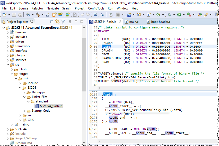

Robin_Shen
Prior to build and execute the code, **the user needs to** :
- Access the linker file and change the current address where the security file is located to match a location in their computers.
Did you build S32K344_SecureBootBlinky project first and change the address of S32K344_SecureBootBlink.bin? (C:\NXP\S32K3_HSE_DemoExamples_1_0_0\S32K3_HSE_DemoExamples\Secure_Boot\S32K344_SecureBootBlinky)

Robin_Shen
Application code that blinks the LED.

7,570件の閲覧回数
Robin_Shen
Please see S32K344_Advanced_SecureBoot/src/target/m7/S32DS/Linker_Files/standard/S32K344_flash.ld:
