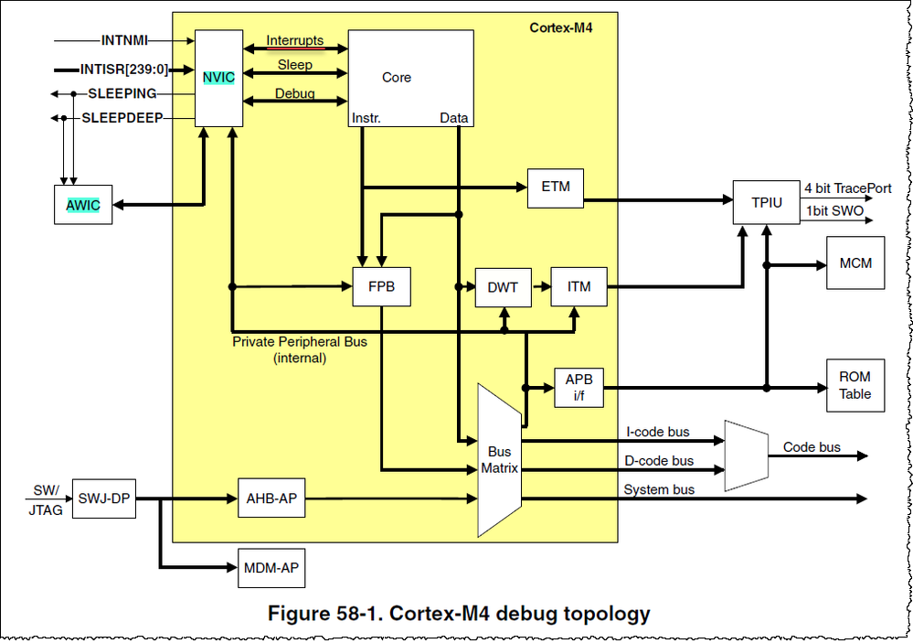

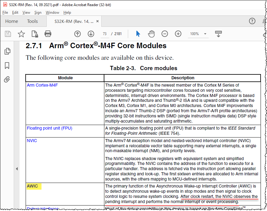

Is there any specific interrupt for AWIC or is it just enable the clock and NVIC will process all pending interrupts.
1,376 Views
Robin_Shen
Hi SreejithN,
No.
After clock restart, the NVIC observes the pending interrupt and performs the normal interrupt or event processing.
