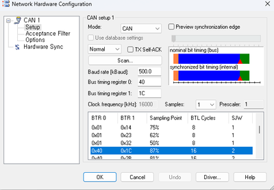

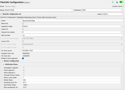

1. When conducting CAN communication using the FLEXCAN component, an error such as a photo occurs in the Vector. Please let me know what to do about this part.
I want to use SPI and SBC to do CAN communication, what should I do?

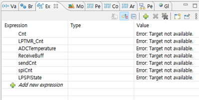

2. During debugging, if I click the debugging Resum button by writing the expressions value with the variable name as shown in the picture below, an error occurs, how do I handle it?

1) se sure board is powered by 12V so SBC and its CAN transceiver is active. Also be sure SBC is in Forced Normal Mode operation (default mode). If not must be configured via SPI, or put back to default mode.
2) Expression window does not show variables if code is running, once you stop code variables are updated.
