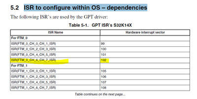

The [SWS_Wdg_00166] requirement is for the WDG driver itself, i.e. the WDG driver shall implement the Watchdog refresh through a GPT ISR - which is already implemented by configuring and linking the GPT channel for the WDG. It's not the requirement for Wdg_SetTriggerCondition() calling, and you can freely call the Wdg_SetTriggerCondition() inside a task. It's also fine if you want to call Wdg_SetTriggerCondition() inside an interrupt handler.
About your problem, you shall need to check whether the interrupt flags for either RTC or FTM was raised, along with checking the interrupt enable flags were set or not. If they were set, then please check whether the interrupt handler were installed correctly. Please note that you need to define the ISR name and set the NVIC ID for these interrupt following with the guidance in GPT Integration Manual,  ISR to configure within OS – dependencies part:
namnguyenviet_0-1632452921192.pngnamnguyenviet_0-1632452921192.pngnamnguyenviet_1-1632452952075.pngnamnguyenviet_1-1632452952075.png
