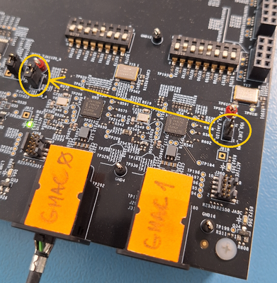

James_Zhang_SE
Hi Pavel,
I have adjusted the project as you have mentioned in the other posts and this thread. However, I'm still not able to ping from PC after making all these changes. I'm using a RAD-MOON2 as the media converter. Can you kindly check if I'm missing anything in my project or what else do I need for the setup?
2,055 Views
PavelL
Hello @James_Zhang_SE ,
Please note: Once an answer is marked as a solution, the original query is no longer actively tracked in our system. I only receive subscription emails for updates, and those can occasionally be missed.
If you need further assistance, the best approach is to create a new query.
I checked your latest project and TX_CLK should be set to output - after the change, your example works on my board well.
Please check on RAD MOON2:
  • Slave mode is set (S32K388 EVB: U97 - bit 7 in middle position -> CONFIG 6 open -> Master)
  • MacSec is disabled
  • Correct speed 1000Mbps is set
Pavel
