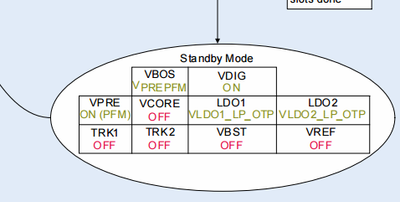

Do you mean you successfully enter into standby mode of SBC?
If so you can see VCORE is OFF of SBC ,can you check whether this mode supply power correctly on your request in MCU side? or VCORE is off ,can your MCU work well?

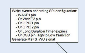

Before enter into standby mode we suggest to configure the wake up source:

Thank you for your answer. I've measured the VCORE and it was OFF when I go to Standby. Further testing, I saw that the issue with the debug port was due to the HSE CLK failed error that was causing a reset on the board approximately 10sec. I was able to correct this by updating the DCF records for HSE clock config.
