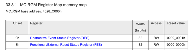

petervlna
Controller resetting continuously.
Check the reason for resets. Read RGM FES and DES registers to see the reset sources.
Peter
