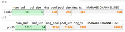

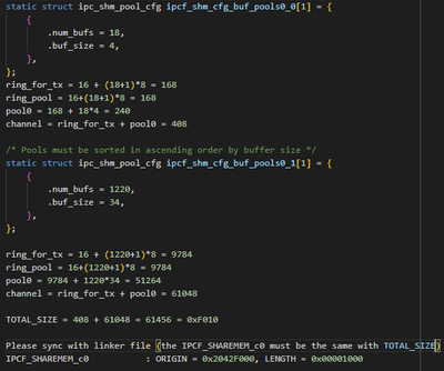

DanNguyenDuy
Hello @Iota,
Sorry for my wrong calculation. This is the correct calculation.
Dan

nxf45396
for new versions of IPCF you can use the defines from ipc_ip_cfg_defines.h
#define IPC_SHM_MEM_SIZE_IPCF_INSTANCE0 0x
#define IPC_SHM_MEM_SIZE_IPCF_INSTANCE1 0x
Costin

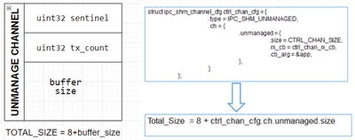

Hello @Iota,
This is the IPCF memory size layout.
nxf78987_0-1701238587427.pngnxf78987_0-1701238587427.pngnxf78987_1-1701238605849.pngnxf78987_1-1701238605849.png
You can refer to the above images to calculate IPCF mem size.
Dan

DanNguyenDuy
Hello @Iota,
Dan
