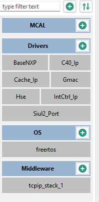

Hi all,
I started to work with S32K344-EVB and use PEMicro.  Everything (build, flash and debug) works fine without HSE. And I'm trying to integrate HSE FW with FreeRTOS. I added HSE driver from S32 Design Studio IDE:
I also downloaded the S32K344 HSE FW 0.2.40.0 SR Release and S32K3 MCUs for General Purpose HSE Demo Examples.
I tried the HSE FW Install and Update from the baremetal examples and they worked fine too.
HSE FW
S32K3 Standard SoftwareAutomotive SW - S32K3 - HSE FirmwareS32K344 HSE FW 0.2.40.0 SR Release
HSE examples for PEMicro
My questions are the followings:
  1. Is it possible to integrate HSE FW Install and Update with our FreeRTOS based project in the same software or should I create a separate FW Install/Update software? If the integration is possible what is the next step to integrate?  Do you have an example or a documentation about that?
  2. Can I integrate all other functions from Demo Examples into 1 project or should I handle the separately?
  3. The examples use files from ARM-software/CMSIS_4 repository, (e.g.: ARMCM7.h, ARMCM7_DP.h,.. ). Why are they important? Can I add these files from "Periferals view"  of S32 Design Studio IDE like a driver?
Thanks in advance.
Sandor

Hi @sandor_b
Since the HSE firmware installation is typically done only once, I recommend creating a separate project. As for updating the HSE firmware, there should be no issues integrating it into your main application.
For clarity, the S32K3 MCUs for General Purpose HSE Demo Examples are provided as separate applications for each use case, demonstrating how each works independently.
Additionally, we provide AWS libraries and an MbedTLS package (with HSE) for the S32K3 product, which includes demo examples that integrate the RTD Driver, HSE Firmware, TCP/IP Stack, and RTOS. These resources might be useful for your application development. It can be downloaded from:
S32K3 Reference SoftwareAutomotive SW - S32K3 - AWS IoT or Automotive SW - S32K3 - mbedTLS.
BR, VaneB
