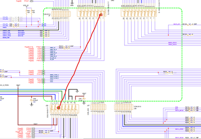

we need to use the Period and Duty Cycle measurement functionality of the eMios module. However, when trying to apply PWM to the corresponding port - the results of corresponding measurement functions are zeros. Is it possible to verify if the eMios ICU works in this mode?
Setup:
S32K3X4EVB-Q172 board. The eMios PWM example was taken as a base one, ICU module was added on top with corresponding functions:

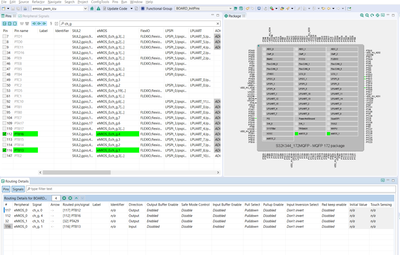

The corresponding additional pin for measurement was setup:
A jumper wire with no resistance was connected between the pins in the following way (shown with red line):
