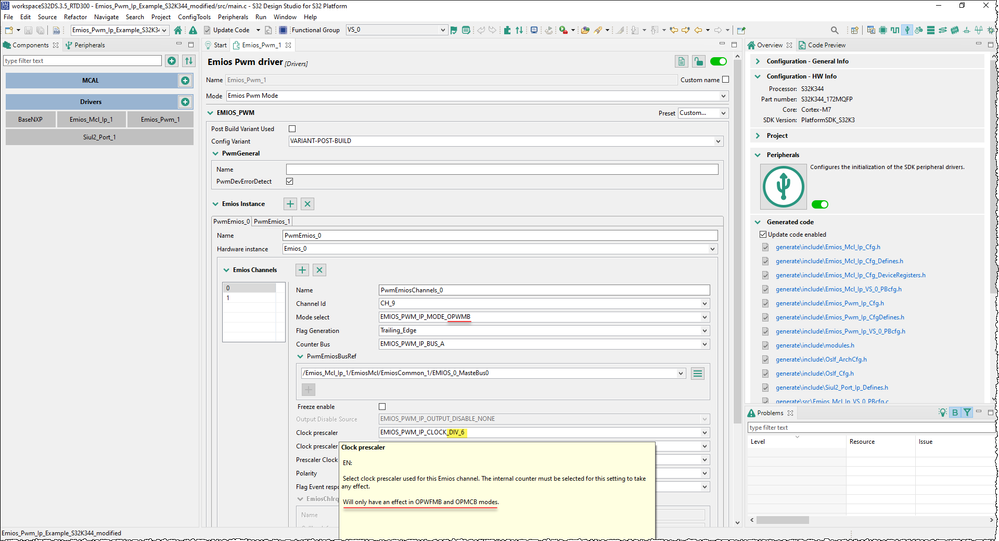

Robin_Shen
Thanks for the feedback.
Note Clock prescaler Will only have an effect in OPWFMB and OPMCB modes. Since OPWMB mode is selected, only global prescaler(Master Bus Prescaler) DIV_16 is active.
6,646 Views
ManishKK
Thanks Robin. I missed that. Good catch!

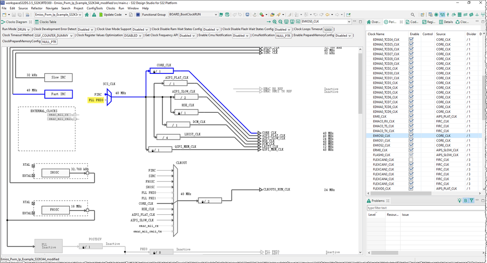

ManishKK
Robin,
Hi.
How do I get an exact value of 200 Hz with a 20% duty-cycle? I get around 201.207 Hz.
I set the global counter to 14999 and the 20% duty-cycle of it as 2999 and it still does not come out to be exact 200 Hz.
6,573 Views
Robin_Shen
Your project select FIRC as clock source of CORE_CLK(eMIOS clock source), please select PLL.
6,540 Views
ManishKK
Thanks selection of PLL worked!
