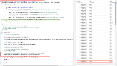

Hello, I have a new question.
Currently, I need to receive a high-speed (with a baud rate of 230400) data stream without idle interrupts and without frame format. I hope to read the data stored in the DMA cache at regular intervals (for example, 100us). How can I achieve this using DMA?

Neo1096
Sorry, there were codes for other functions in the code I uploaded before
I'm using the RTD4.0 library. The demo you uploaded seems to be 1.0. The configuration seems to be different. For example, when configuring the DMA logic channle of DMA in RTD4.0, there is no option to Enable DMAMUX Source. Is there a routine of UART-DMA without MCAL for the RTD4.0 library?
My current problem is that it has always been in a busy state when Lpuart_Uart_Ip_GetReceiveStatus occurs, so I have been in this loop and cannot jump out.

Senlent
Hi@Neo1096
I'm not sure how you tested it, here is a screenshot of my test, is there any problem?

Neo1096
My previous test was to short-circuit the TX and RX of the chip
If I use the serial port assistant, the problem I had before won't occur
3,953 Views
Senlent
Hi@Neo1096
This example is based on RTD 4.0.0, LLD, the same version you are using now.
3,942 Views
Neo1096
Thank you very much. I understand. The code works now, but there are still two questions that I don't understand
In the main function, using "Lpuart_Uart_Ip_SyncSend" can interrupt, but it cannot receive data correctly. If it is changed to "Lpuart_Uart_Ip_AsyncSend", it can still run. What might be the reason?
2. What was sent was "Hello, This message is sent via Uart!" \r\n, but there will be one less /n when receiving. If I change the code to Lpuart_Uart_Ip_AsyncSend(0, WELCOME_MSG, strlen(WELCOME_MSG)+1); Then /n can be received. What could be the reason
