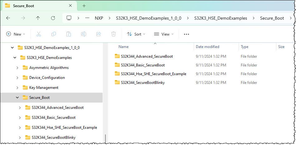

Hello
I am using the S32K344 EVB board for development work. I would like to implement the secure boot function. Is there any example?
BestRegards,
Simon
2,440件の閲覧回数
Robin_Shen
Hi Simon,
I suggest you take a look at the example in S32K3 MCUs for General Purpose HSE Demo Examples (S32K3_HSE_DemoExamples)
S32K3_HSE_DemoExamples Secure_Boot examples.jpgS32K3_HSE_DemoExamples Secure_Boot examples.jpg

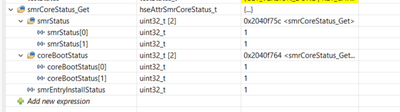

Hi Robin, I tried to transplant SHE SecureBoot example from the S32K344 HSE Demo Examples to S32K312,  but when I debug , at the end of ConfigureSHESecureBoot, the smrCoreStatus_Get
as below, but after reset(icon as below), the code can't run to AppBL, so what should I pay attention when I transplant?
