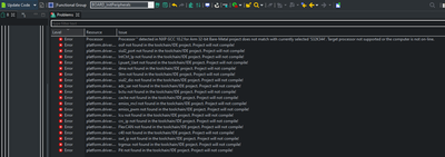

Hello NXP team!
1. Does anyone know why I've got those problems poped-up at the peripheral utility of my project ?
2. Is there any way I can solve them ?
3. The weird thing is that the drivers and new generated files are added into my project despite the warning messages "...Project will not compile!"
Kind regards,
kyf

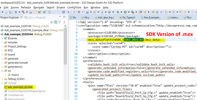

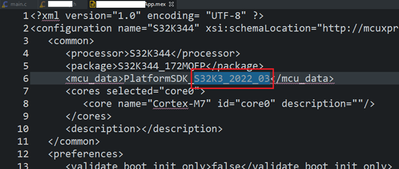

I imported your .mex file to a new blank project and able to fix the issue  reported by click on "Add SDK component...". I've also check the S32DS and RTD version installed, and it's the same with your environment. So I think you should re-install S32DS 3.4 Update 3 to see if the issue still happend
About your question regarding the link between RTD, .mex and Configuration tool:
- .mex file stores all your configuration of IPs or Drivers in S32CT (Configuration Tool) for your configuration. When clicking on "Update code" button. S32DS tool will generate configurate source code (.c and .h) for your configuration. The path of template file will see in S32DS installation "components" directory : (i.e C:\NXP\S32DS.3.4\eclipse\mcu_data\components\PlatformSDK_S32K3_2022_03)

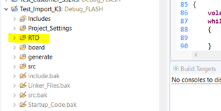

- After clicking on "Update code" button, a folder name "RTD" will be added into your project:
this folder contains src and include files base on IPs and Drivers you configured in S32CT. The resource of this folder is from S32DS installation "S32DS\software" path (i.e C:\NXP\S32DS.3.4\S32DS\software\PlatformSDK_S32K3_2022_03\SW32K3_RTD_4_4_2_0_0_D2203)

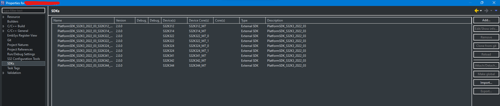

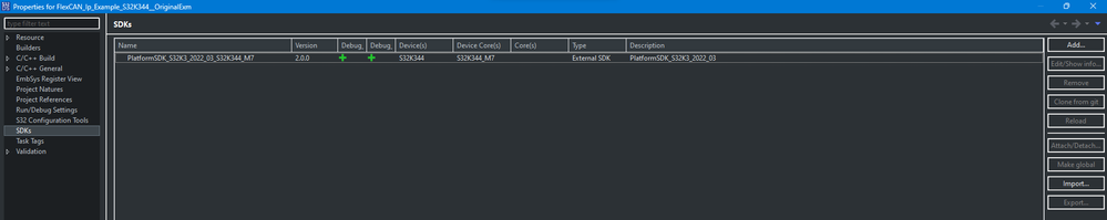

In my project RTD are not generated as they should. I don't know which depedency is missing that causes this behavior.
This is happening only for this specific project that I'm working. All new projects or other projects that I have myself created works as it should (mex, drivers, tools, code generator etc).
I can share with you a screenshot from the project properties that I've noticed that it is different with other projects.
Project with problem:
Project without problem:
I have used diff tool to find the difference between the two .cproject .project files but I could not locate this part with the SDK. That's why I've asked about the RTDs-mex-Poject depentencies and include paths.

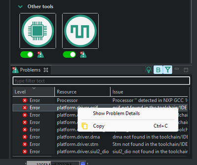

Hello @cuongnguyenphu .

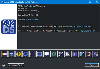

Thank you for reaching out. I've tried to apply your first suggestion but the option "Add SDK component..." is missing.
The second suggestions of yours I have already tried before and it does update the code but the problems shown before persist.
I've tried to use this button also but it didn't work.
The S32DS IDE version that I'm using is this:

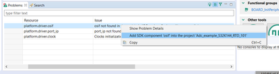

cuongnguyenphu
How did you do when creating the project. This issue sometime happen when you import .mex file to a plain project.
To fix it, just simply right-click add choose "Add SDK component ..."
Or click on Update code button, it will automatically add these modules and generate code.
