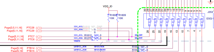

I was trying to test the I2C example code on S32K344 EVB board, as description noted, do I need to add the pull up resistors additionally or resistors are inserted on board, no more connections needs to do? Thanks.

The example uses PTC6 and PTC7 for the LPI2C.
There are pull-up resistors on the board already.

Hi @yqs77,
Please specify
  • Name of the example, RTD version
  • EVB part number, revision, schematic number
Thank you,
BR, Daniel
3,092 Views
yqs77
RTD version is SW32K3_RTD_4.4_1.0.0_D2110.
Example name is SW32K3_S32M27x_RTD_R21-11_4.0.0\eclipse\plugins\ I2c_TS_T40D34M40I0R0\examples\S32DS\S32K3XX\I2c_Example_S32K344.
Board version is S32K3X4EVB-Q257 47827 PCB RevX1 SCH RevA.
Thanks.
