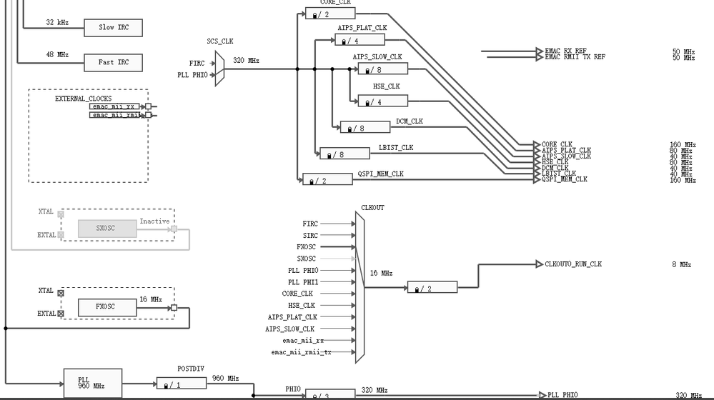

Can the main frequency of this chip reach 320M? Is Core_clk the main frequency on the configuration tool? This can only be configured to 160M, and I want to set the main frequency of this chip to the highest.

It cannot operate at 320MHz.

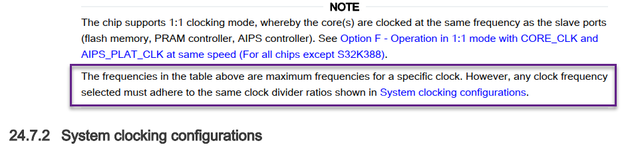

Table 143. System clock frequency limitations (For S32K344, S32K324, S32K314, S32K342, S32K322, and S32K341).
Use one of the clock options:
24.7.2 System clocking configurations.
