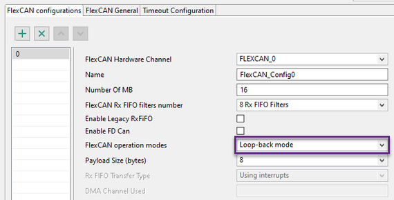

I am using S32K344 and New "FlexCAN_example_CT(SDK version: RTD 0.9.0 D2013)",Update the code after modifying the CAN0 IO configuration.But CAN0 did not send any information, use the oscilloscope to check the CAN0 PTA6 level and there is no change.After checking the code, I found that the updated code did not add IO initialization information, so I added the function Siul2_Port_Ip_Init(NUM_OF_CONFIGURED_PINS0,g_pin_mux_InitConfigArr0).It still doesn't work after adding IO initialization.

Hello @longfeiwang,
Could you please share the project so that I can test it?
PTA6 is a CAN0_RX pin.
Have you read the corresponding MSCRn registers of the TX, RX pins after the initialization?
Were the correct source signal selected in the registers?
Thank you,
BR, Daniel

danielmartynek
Hello @longfeiwang,
I'm sorry for the delay,
You haven't changed the FlexCAN mode:
Please have a look at the description of the FlexCAN modes in the S32K3xx RM:
