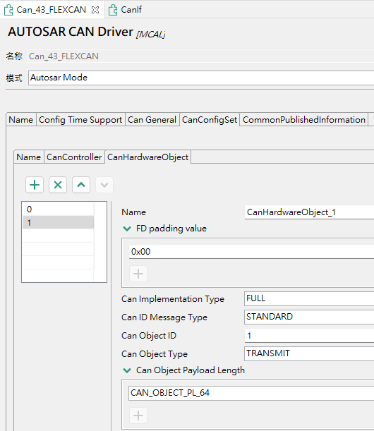

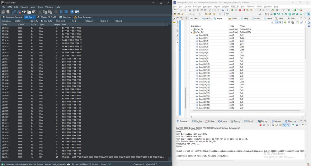

When I use PCAN-USB pro to recieve 64 bytes data from S32K344.
PCAN-USB pro only recieved the first 8 bytes, and the remaining 56 bytes are missing.
When I use PCAN-USB pro to transemit 64 bytes data to S32K344.
S32K344 recieve 64 bytes data successfully.

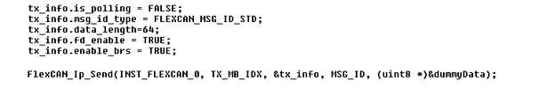

have you set the tx_info parameter properly to use CAN FD frame with desired payload size?
BR, Petr

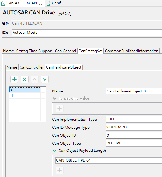

I am using MCAL to build this project.
In the previous message, I attached my project.

I am not able to view/download project. So be sure you updated Can_PduInfo as per need.
BR, Petr

try to remove Can_43_FLEXCAN_SetControllerMode calls after sending message. Not sure why you stop/start controller.
BR, Petr

Platform:S32DS3.5
SDK:PlatformSDK_S32K3_S32K344_M7-5.0.0
I connected channel 1 of the oscilloscope to the S32K344's CAN H, and channel 2 to the S32K344's CAN L, and obtained the following waveform.
I have already set the CAN payload to 64 bytes, but the DLC shown on the oscilloscope is still 8 instead of 64.
