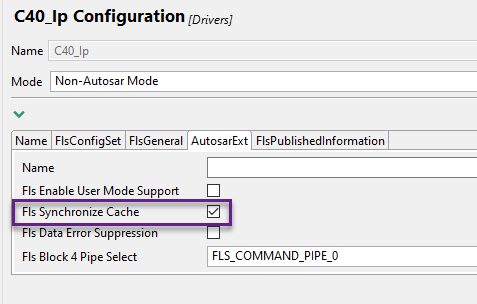

Hi @FredM,
There is no need to place the code to SRAM if you program another block, e.g. programming the 0x00600000 block from the 0x00400000U block.
This looks like a cache problem.
The driver synchronizes the cache if this option is set:
