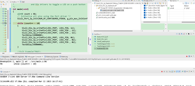

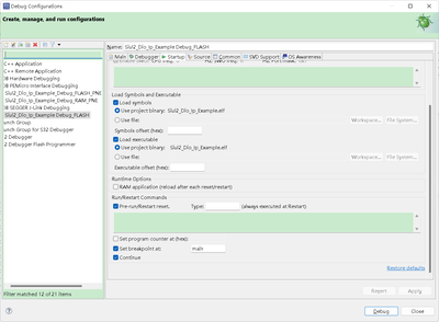

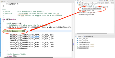

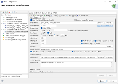

SEGGER Jlink debugger can program S32K344 project, but during debugging, the breakpoint is incorrectly positioned in the middle of the main program instead of at the beginning. Breakpoints added before the breakpoint will not be paused when the program runs there

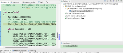

But I find that it seems to have something to do with the running time,
Because when I add a delay, The breakpoint is positioned at a new location.
At the same time, I found this situation
It's going to refresh very quickly to look like this

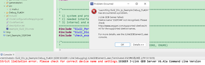

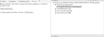

In addition, the first debug after the code has been modified and recompiled always fails
as shown here

BrainLoader
Hi @Senlent ,
Thanks for your reply.Of course I will send you my project.

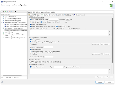

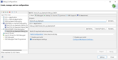

But I wonder if it's because of the debugger setup.

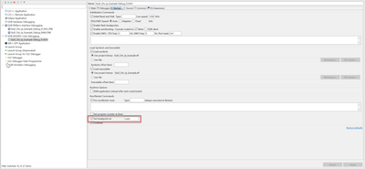

Because I used only modified the pin related in the example project.
And then these are my debugger configurations.
BrainLoader_1-1679909917920.pngBrainLoader_1-1679909917920.pngBrainLoader_2-1679909940611.pngBrainLoader_2-1679909940611.png
4,603 Views
Senlent
There is no problem with your settings
It seems that you have modified the default version of J-LINK and GCC

The Jlink driver supplied with the S32DS seems to be too old and is causing errors at compile time

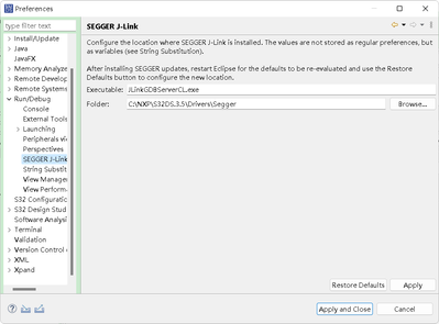

I updated my Jlink driver version to 7.86e and set it to the default path,
but the problem still occurs
