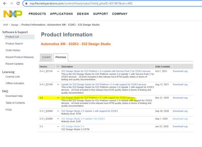

Dears,

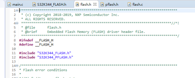

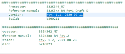

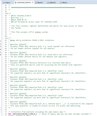

         recently , I am working on a project porting from k344 to k342, and I met a issue as below: the original program of k344 using a headfile whose version is "rev. 1.1,2020-02-11", but the headfile version of  the new project I made for k342 is"rev. 1.2,2021-08-23", both shown in the picture below. the the issue comes, the new version cannot work well with the old program source file which comes from the old original program of k344, and many compiles errors came out. one obvious error is the macro definition of "FLASH" in main.c of the old original k344 project can be found in the headfile of  "s32k344_flash.h", but this cannot be found in the newer version of headfile "s32k342_flash.h".
       so here I want to know where I can download the older version of k342 headfile? Cause I searched all the related files on my computer, all their version are older than "rev. 1.1,2020-02-11",some are "rev. 1.2", even some are "rev. 1.4". and I also check the NXP website, I still can not find where I can get that , so anyone can help me on this?

cuongnguyenphu
Which are packages that you used for both  k344 and k342? Can you capture it for me?
OR can you capture me the source file version of these both k3k344 and k342?

Fidel

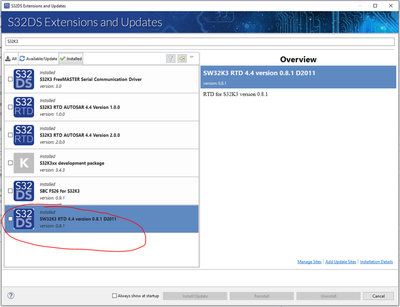

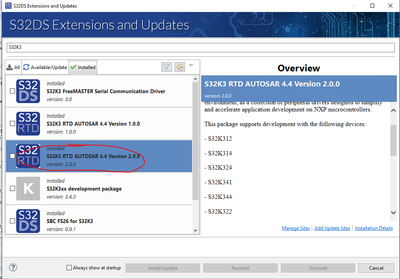

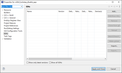

 I check the 2 projects for the information you mention , as to k342, I made it from File->New->S32DS->Application Projects, and I did not choose any SDK. and then I copy the whole include folder from SDK2.0 version from the folder installed on my computer ,the location is C:\NXP\......., I forget the concrete location. and as to K344, I got it from another people(maybe offical? i donot know) , and I check  the SDK, I found it is blank , just shown as below. I also searched "FLS_VENDOR_ID" in these 2 projects , but I found none. could you please tell me how to find them? or anything else I can give you? thanks a lot ~
2,278 Views
cuongnguyenphu
I got this Version information from Fls.h file. But you can find this information in any Plugins source file (.c and .h). Because you mention that your error is in Flash module, so I suppose you are also use Fls.c and Fls.h
