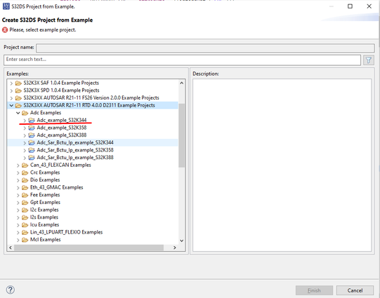

Hi Everyone. I'm somewhat new to this Autosar and NXP S32DS. I'm working with S32K324 MCU and I want to configure RTD for that. I downloaded S32K3 Standard Software Package and RTD. But I was unable to find the S32K324 Examples. How do I choose correct package which contains the Examples of S32K324.

the example SW in directly in the RTD package.
In S32DS you simply select FIle->new-> project form example
You will use S32K344 examples which are valid for whole S32K3x4 family.

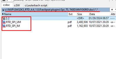

Hi petervlna, Thanks for the reply. I'll refer them. I just want to know one thing. I want to find RTD APIs for LPSPI. I tried to search but haven't got any luck to find out the API documents. I would be much thankful if you suggest any docs or trainings.

The API documentation are embedded directly in RTD installation.
Each module has doc folder:
You will find trainings on our web page:
https://www.nxp.com/design/design-center/software/automotive-software-and-tools/real-time-drivers-rt...
refer to section Training.
