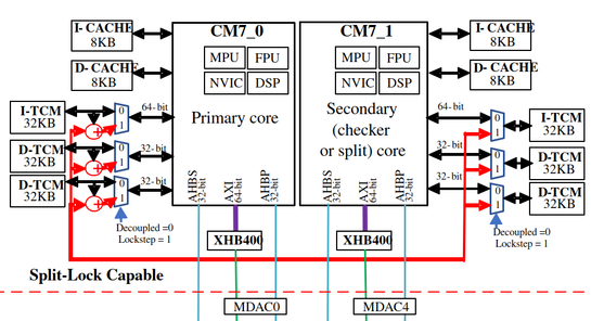

This is regarding the usage of DTCM-0 and DTCM-1 in S32K322.
In our current project we are having a single binary for both the cores which leads to the storage of all global variables which are mapped with DTCM, use up DTCM of core-0.
All the SafeOs task stacks are allocated to DTCM-0.
I have a few questions:
1. If TCB stacks of master core and slave core tasks are uninitialized and mapped to DTCM-0, then at runtime core-1's task would automatically use up dtcm-1 since both DTCMs have same address? If not-> follow point 2.
2. How exactly can we manually map the data section for slave core's stack to core-1's DTCM?

Hi @Akshat_VE02376,
CM7_0 has direct access to DTCM_0, while CM7_1 has direct access to DTCM_1.
CM7_1 cannot directly access DTCM_0; it can only do so via the backdoor interface
Each core (CM7_0 and CM7_1) has its own linker file and startup code, which allows for independent allocation of stack and memory regions.

Hi Daniel,
Is there no way to have a single linker and use up core-1's (slave core) DTCM-1 when both cores are active?
I really need this clarification for a closure!!
2,151件の閲覧回数
danielmartynek
Hi @Akshat_VE02376,
Yes, that is possible.
In RTD 2.0.0, there was this example: Platform_Multicore_SingleElf_S32K324
The example has just one linker file.
Install S32DS 3.4 and add RTD 2.0.0 so that you can create a project from that example.
