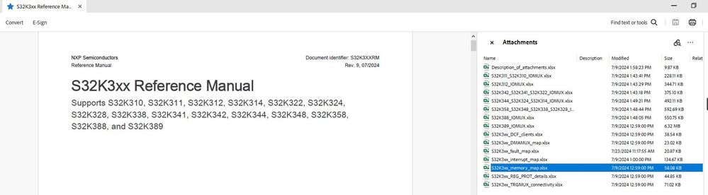

Where can i find the S32K322 Memory Map(excel sheet or *.h ) file.

Hi@NagendraPothula
1.You can find such document in our datasheet's attachment.
2.STANDBY RAM content retention during Standby mode
