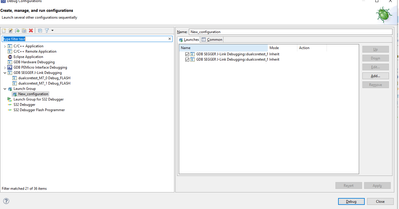

The SEGGER plugin in S32 Design Studio supports launching a debug group, which allows you to program and debug multiple cores simultaneously.

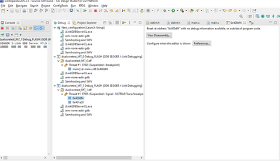

I have already using the Group Debugging, the issue is S32DS Ide getting hanged or become non-responsive during the debug session.
See below image
And also If I put a break somewhere in While(1 ) loop of point in CM7_1, break point does not hit.

I cannot reproduce this behavior.
It seems that the second debug session for CM7_1 debugs code from the same memory region (0x400000) as the first debug session.
Can you maybe share the test project?

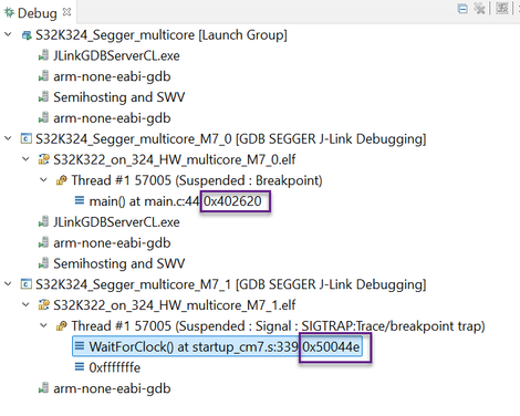

Here you can see that both cores work in different flash blocks, unlike in the screenshot you posted.
I have tried loading your application on S32K324 which should be possible, but I get a different error than you.
The debug configuration of the second core should have this disabled:
But you have that in the project.
