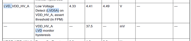

Senlent
Hi@AbdNxp
"Now, when I reduce the power to 2.9V debugger notifying target power lost."
I think you have some misunderstandings here. If it is lower than 2.9V, it should be an LVR event rather than an LVD event. By default, an LVR event will cause a POR instead of an interrupt.
For LVD:
