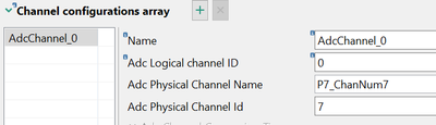

hello, NXP teams ,
I'm using S32K322 and using ADC modules, I'm using S32DS and SDK to config this modules.
when I calibrate the ADC channel , it returns error.
when I read the value ,it returns 0x3fff(i set KidhRobin_2-1702723432733.png),but I measured the AD port ,the voltage is 0.6v;
and other AD port is the same issue.
Does anyone know how I might go about solving this problem?
Thank you
Below is my config:
AD Clock :
my clock config as this ,and my VREFL is 3.3V
KidhRobin_5-1702723961249.pngKidhRobin_6-1702723984843.pngKidhRobin_7-1702724015496.pngKidhRobin_8-1702724055947.pngKidhRobin_9-1702724081998.png

Hi @KidhRobin,
Can you please double check the ADC calibration frequency?
The max. S32K322 ADC calibration frequency should be 40MHz.
Thank you,
BR, Daniel
