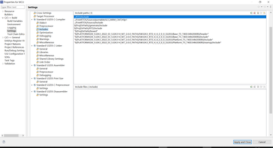

In the locally created S32K314 project, the SDK include file points to the local SDK installation path.  Before S32K148 project, SDK include file is under the SDK folder in the project;  Can the SDK include file path be configured in the S32K314 project?
3 返答(返信)
3,557件の閲覧回数
Senlent
Hi@wang_q4
Are you looking for this setting?
3,533件の閲覧回数
wang_q4
Hi,this is my setting

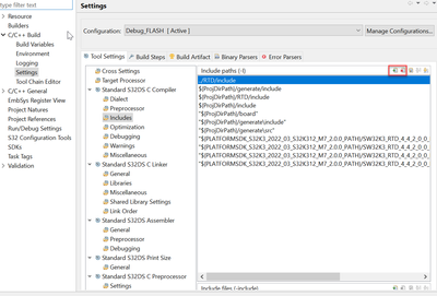

Senlent
Hi@wang_q4
You can add the file paths you need here, is there any problem?
