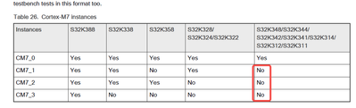

Hello
I saw in Table 5.S32K3xx chip's feature comparison in the S323XXRM manual that the RAM of the S32K314 has 512KB, which contains 96KB of TCM.
But in Table 90.Memory configuration, S32K314 has 160KB SRAM0 and 160KB SRAM1, as well as 32kB ITCM and 64KB DTCM.
All the above mentioned RAMs total only 416KB, which is 96KB short of 512KB. Where is this 96KB?
BestRegards
Simon

Yes there is only one core. But you can use whole TCM.
You will just access it via backdoor. You can see the address in the memory map for backdoor access are different as I have posted earlier.
You will use backdoor for any other master except core which is tight to memory. For example also for DMA access.
Peter

That is the TCM from other core. You can use it even if core is not present via backdoor access.
Peter

Hello Peter,
But according to the record in this table, S32K314 has only one core, how can I use the TCM of other cores?
BestRegards,
Simon
Peter

That means other Masters including Core M7_0 can also access TCM1 through the backdoor, right?
BestRegards,
Simon

yes, that is the case.
