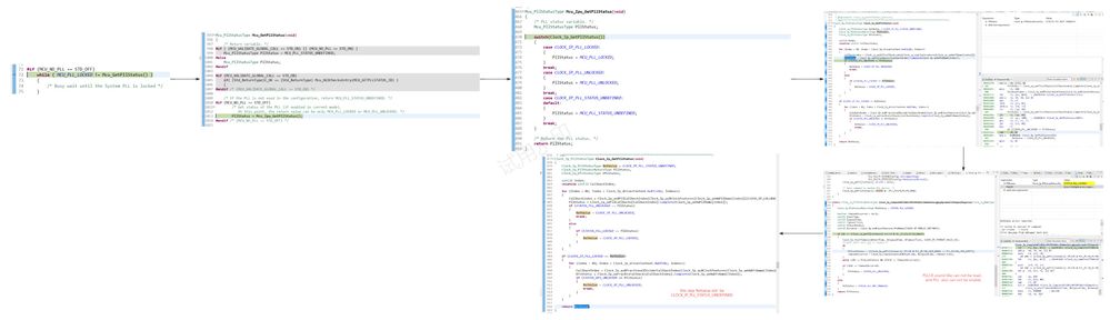

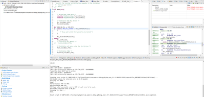

Hello everyone , I miss a question When I debug the S32K314.
I found that the program is stuck at line 72. It seems that the PLL has not been enabled, and its status cannot be obtained. For the specific process, please refer to the JPG.flowchat.jpgflowchat.jpgIs this a configuration issue with S32DS or something else? please, someone help me
1,091 Views
danielmartynek
Hi @Dqc,
Before you call this function, the clock driver is initialized, right?
Can you share the clock configuration, preferably the .mex file?
Which version of RTD do you use?
Thank you,
BR, Daniel
