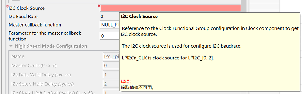

S32K314 I2C clock source is empty
1,293件の閲覧回数
H_NXP

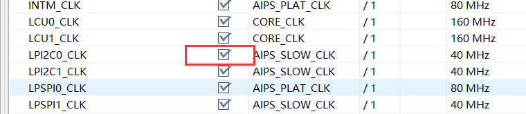

When I add the I2C master mode in the project, it prompts a clock error, but I have already checked the clock. How can I handle this?Thanks for the answer!

Robin_Shen
Please add Clock_Ip_ReferencePoints Driver and select AIPS_SLOW_CLK.
