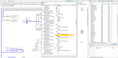

I'm working on the S32K312 evaluation board and have the problem that the board resets when the debugger is not connected.
The program executes correctly for 1 second and then a reset is performed. This is repeated for exactly 10 times, afterwards execution stops completely. When I push the reset button (or power off and on the board), this whole behaviour starts again.
As mentioned, this only happens when the debugger (USB/PEMicro) is not connected. I run a very simple test program from the examples which toggles the user LED in an infinite loop. When the debugger is connected, the loop is really run infinite as expeced. So I'm quite sure that the user code is not triggering the reset.
First I was assuming that it is because of the watchdog of the SBC (FS26). But all the jumpers are set as in the default config (as described here Getting Started with the S32K312EVB-Q172 Evaluation Board for General Purpose | NXP Semiconductors), and accordingly the watchdog should be disabled by closing J1.
Maybe anyone has an idea what that could be or already run in the same problem. Thx for the help!

peterhausberger
Hello @VaneB,
Thanks for your reply! I tried to create a minimal application which causes the problem, see attached.
First I created an empty project (File > New > S32DS Application Project) which just runs an infinite loop. Here the issue didn't occur. Then I added the lines for clock initialisation:
#include "Clock_Ip.h"
Clock_Ip_Init(&Clock_Ip_aClockConfig[0]);
When I then flash/debug the program, disconnect the debugger and do a manual reset (by pressing the reset button), the reset problem occurs, i.e. the board resets itself after 1 second. This can be seen by the reset LED flashing (only very short).
So it might be due to invalid clock settings? I did not change anything at the default config. The clock init is not needed in this sample code, but I need it for my projects (UART, CAN, ...).
Unfortunately, I cannot check the MC_RGM register, since I have to disconnect the debugger to trigger the problem.

atranzillo93
I have the same problem and I have found the root cause:
https://community.nxp.com/t5/S32K/S32K312-uC-reset-after-1sec-from-power-on-caused-by-writing-MUX/m-...
I have seen that the reason of reset is when I try to write DIV bit of MUX_0_DC_2 register with a value different from 1.
I hope this can be useful for you.

VaneB
Hi @peterhausberger
Sorry for the inconvenience this may cause.
There is a problem with the RTD v3.0.0 for the S32K312. The recommendation at this moment is to use the RTD v2.0.3.
Please use this version, and if there is any other problem, let me know.

baris_celikcapr
I had the same issue and I only change MC_CGM_MUX_0_DIV3 from "1" to "2" and it solved my issue.

bryan_brauchler
Hello @peterhausberger
Couple things,
1. 60MHz should be the default HSE_CLK due to HSE Gasket defaults. If you wish to run the HSE at 120MHz you will need to configure the gasket in the DCF Record area. See S32K3xx_DCF_clients.xlsx attached to the reference manual for details.
2. You can check the reported reset reason using the ERM - this will indicate either an external reset or indicate the internal reset source
3. Please make sure that all cores have entered WFI before calling the clock switch:
(32.11 in the RM)
This can be a common cause of the described behavior, as the debugger will delay clock initialization enough for the SBAF to park the HSE core. Changing this clock before the HSE core is parked will cause lockup on the HSE core triggering HSE WDG reset.
