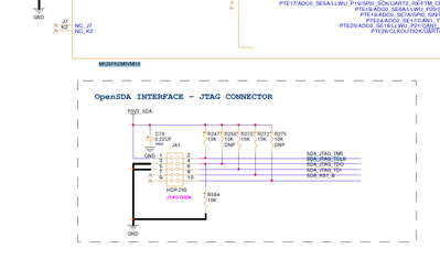

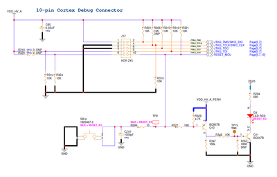

Why there are two JTAG connectors on EVB? Please refer attached image. When I initially attached debugger to green color highlighted connector, it does not work. When I connect it to J12 highlighted with pink color, it worked.
Also problem is that I do not find JTAG connector highlighted with green color in design files schematic and PCB layout. I can find only J12 connector.
Hope this post will help others who have same confusion as me.

Julián_AragónM
Hi @AshishDargad,
The pink interface you highlighted refers to J12, which is the debug connector for the S32K312 MCU. The J41 interface is connected to the On-Board debugger for communication with the MK26.
Julián

I have done connections as below for JTAG connector from 10 pin to 20 pin lauterbach connector of LA-7844 debug cable
10 pin                 20 pin ARM Standard JTAG
1 VCC                 1 VREF-DEBUG
2 TMS                 7 TMS
4 TCLK               9 TCLK
6 TDO                13 TDO
8 TDI                  5 TDI
10 RST                15 RESET
3,5,7,9 GND       4,6,8,10,12,14,16,18,20 GND
