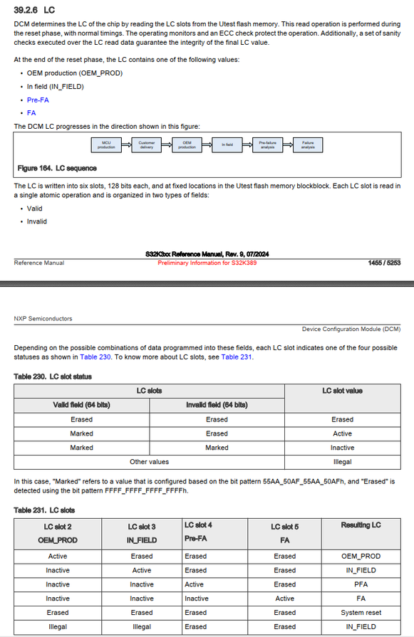

Hi NXP,
   i want to use jlink to get chip lifecycle status. it's better not to download a proxy program and call hse api to read the value.
   is it possible to get lifecycle value from utest area, then jlink can read the value directly? thanks.
1,498 Views
davidtosenovjan
I am not completely sure, but RM defined LC slots in UTEST memory which you would definitely have to use in case HSE firmware is not installed.
But when HSE is installed, documentation says that
"The users can check LC by HSE “get attribute” (HSE_SECURE_LIFECYCLE_ATTR_ID) service."
what is not mutually exclusive to previous approach, in my opinion.
