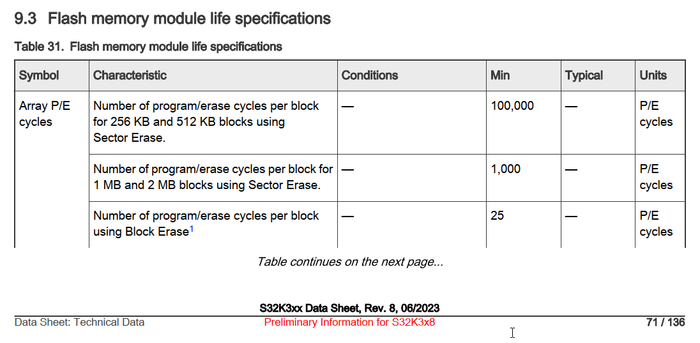

  • How to calculate S32K312 Data Flash memory cycle endurance is what

Cycling endurance is specified in the device's datasheet. Code flash belongs to 1000 P/E cycles, data flash to 100000 P/E cycles.
