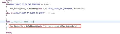

My customer is developing T-box. They use uart to communicate with a 5G module, and meet an issue. The 5G module continuesly sends data with UART in a very shot interval, about 1-2ms, 230400bps. Then we will see severe  frame will lost.
  Here we can see the function call:
Seems in the uart IDLE irq, the RTD low level code will stop the DMA and receiving, then open it again. This mechanism will create a receiving gap, during this gap, the DMA cannot receive data. So if the sending interval is too short, it may lose frames.

After testing, you can use below code to replace the AbortReceivingData( ) function and UartReceivingData function to reduce the gap. And I attached a dual buffer example with S32K344 and lower version RTD for your reference, it can be easily migrate to RTD2.0.1.
             /* Enable LPUART0 idle receiving */
        IP_LPUART_0->CTRL |= LPUART_CTRL_ILIE(1);
        Lpuart_Uart_Ip_SetRxBuffer(INST_LPUART4, uart4_DMA_recv_buffer1, RX_BUFFER_SIZE);
        /*reset the Buffer address to DMA as well.*/
        IP_TCD->TCD1_DADDR = uart4_DMA_recv_buffer1; /*in my code TCD1 is used for UART RX, please choose the right TCD in your application*/
        IP_TCD->CITER1.TCD1_CITER_ELINKNO = RX_BUFFER_SIZE;

Thanks very much for your support, it works.
