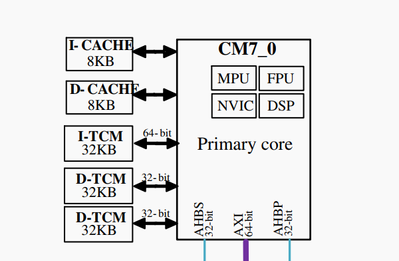

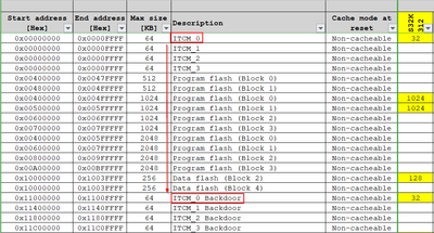

Hello NXP experts,
As listed in RM 21 / 4649, Figure 6. Block diagram – S32K312,  No backdoor access method available for CM7_0, but in the memory map, there'are TCM back door address.
And I can access the ITCM backdoor address, to change value of variables. My question is
for S32K312, M7_0 core accessing TCM backdoor is realized by direct mode instead of backdoor mode, as you can see no backdoor switch is listed in the block diagram, while like
the blelow chips, there're rea switches around the TCM for user to select the backdoor mode.

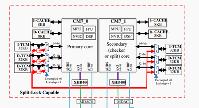

page 22 / 4649, Figure 7. Block diagram – S32K322, S32K342 and S32K341,
Look forward  to your professional response.

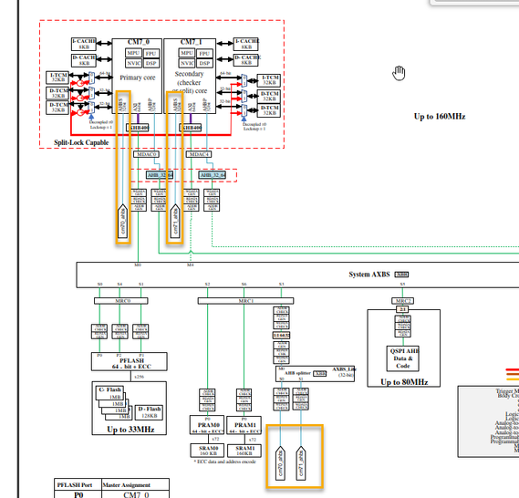

davidtosenovjan
Red arrows do no show backdoor access, it shows running in split-lock configuration i.e. running in decoupled or lockstep mode.
Backdoor access marked below by yellow:

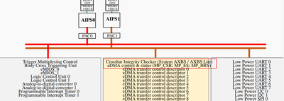

I get your point. Previously I misunderstood the backdoor path. The reason I'm curious about the backdoor access method is dueo to  the TCM error injection.  TCM error inejction will use the backdoor address to write and read the same address. During this write and read, Specific EIM channel will invert 1 bit in the data path or address path, and XBIC will detect this kind of error thru the below red marked " Crossbar Integrity Checker (TCM backdoor AHB Splitter)", the below picture is truncted from Figure 7. Block diagram – S32K322, S32K342 and S32K341, page 22 / 4649.
However for Figure 6. Block diagram – S32K312, no Crossbar Integrity Checker (TCM backdoor AHB Splitter), does this mean no real detection in XBIC side for S32K312 EIM for TCM write and read?

The XBIC is sub-module verifying the integrity of the attribute information for XBAR transfers using an Error Detection Code (EDC). The XBIC integrity checking is independent from the memory's ECC that covers the address and data.
For ECC error injection to the TCM data use EIM to simulate fault reading.
According Table 264.EIM channel mapping - S32K3x1, S32K3x2, S32K344/S32K324/S32K314
you may inject ECC error to frontdoor read access (channels 13-18) as well as to backdoor read access (channel 20).
