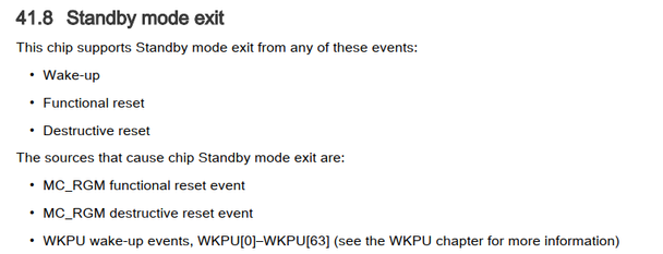

Hello
This phenomenon was discovered during testing: after entering StandBy, a Reset occurred (by pulling the Reset Pin low). The ResetReason read after the reset was Wakeup, but in normal RUN mode, the Reset Pin was read low after the reset. The ResetReason taken is an external Reset.
may I ask if this is normal?
BestRegards,
Simon

Hi @Simon-Liu,
I understand that by WAKEUP_REASON you mean MODE_STAT[PREV_MODE = 1] the previous mode was standby.
However, when F_EXT occurs during the Standby mode, the RDSS register is set.
In this case, we should ignore the state of MODE_STAT[PREV_MODE].
My tests shows that MC_RRGM_FES[F_EXR] is set when an external reset_b reset occurs during the Standby mode.

Hi @danielmartynek
I use the Power_Ip_GetResetReason interface to read the reset reason. In the interface, I found that when the return value of the function Call_Power_Ip_MC_RGM_ResetDuringStandby is not 0, the reset reason is set to WAKEUP. The return value of the Call_Power_Ip_MC_RGM_ResetDuringStandby function is determined based on the value of the RDSS register.
Based on the above code logic, can it be understood that if a reset occurs during Sleep, the reset reason read using the interface Power_Ip_GetResetReason is WAKEUP?
BestRegards,
Simon
2,633 次查看
danielmartynek
Hi @Simon-Liu,
Yes, that is correct.
The driver reads the RDSS register, and if any of the bits is set, the driver considers the reset to be a wakup event.
