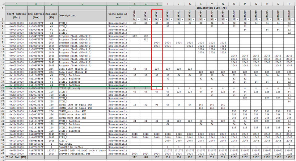

I have a few queries related to the OTP region.
What is the start address and size of OTP in S32K312?
I would like to store a 4K key into this memory . Is it possible.
How do I ensure that this region is locked and read -only?
Is this region accessible from any Flash Bank ?
Also, are there any dependencies in terms of HSE operations when HSE is enabled on this region.
2 返答(返信)
1,584件の閲覧回数
petervlna
0x1B000000 and 8kB is size.
petervlna_0-1722925376017.pngpetervlna_0-1722925376017.png+
You can store it here, at first free available address. Depending on your DCF usage
It is by default from NXP facotry.
Yes
No, HSE will use only blocks defined for HSE usage. There is no choice.
