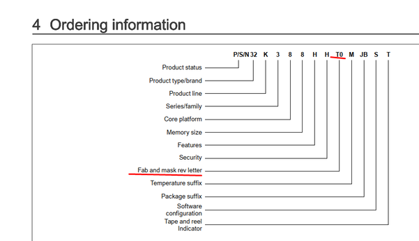

Hello NXP Support,
We are developing TPMS controllers using S32K312HVS MCUs.
Currently sourced from China (Rev: 0P09C), we are transitioning to Malaysia production (same MCU model).
For Phase 1 validation, please confirm the following:
1. SILICON & FIRMWARE COMPATIBILITY
- Will identical firmware binary (we developed ourselves) run identically on Malaysia-sourced S32K312HVS without recompilation?
- Are there ANY silicon-level differences between China and Malaysia MCUs (same part number)?
2. SPECIFICATION CONSISTENCY
– exact match on Malaysia MCUs?
- Reset module (RGM: FREC/FRET/DREC/DRET counters) – identical behavior?
- FlexCAN peripheral (500 kbps, ISO-TP) – no variations?
- Clock accuracy & PLL lock time – same specs?
3. ERRATA & WORKAROUNDS
- Current firmware includes workarounds (RGM escalation, CAN timeout handling).
- Are these workarounds still valid on Malaysia MCUs, or do we need adjustments?
- Any NEW errata specific to Malaysia production?
4. PROCESS VARIATIONS
- Any electrical parameter shifts (timing, power, temperature coefficient)?
- ECC reliability differences on Malaysia-sourced Flash/NVM?
Please confirm: Can we use the SAME firmware binary and expect IDENTICAL product
behavior on Malaysia MCUs, or are adjustments required?
Timeline: Phase 1 validation starts in the end of September. Your quick response would be appreciated.

The S32K3xx ordering part number system uses a "N" prefix to designate "Non-China manufacturing qualified ordering part number." This is purely a sourcing/ordering designation. Critically, it does not indicate a new mask set or silicon revision — the same die/mask (0P09C) is used. The Malaysia assembly/test site is ATKL (Petaling Jaya, Malaysia), which is NXP's qualified assembly and test facility for the S32K family.
What you have to pay attention is the mask revision
The "N" prefix is essentially a supply chain resilience and geopolitical risk mitigation tool. It gives customers:
Guaranteed non-China assembly & test — the device is assembled and tested exclusively at non-China sites (e.g., ATKL Petaling Jaya, Malaysia). Customers who have contractual, regulatory, or policy requirements to avoid China-origin manufacturing can source the "N" variant to satisfy those requirements.
Export control / trade compliance — some customers (especially in defense-adjacent, government, or regulated automotive supply chains) are required to document and control country-of-origin for components. The "N" variant provides a clean audit trail.
Supply diversification — having both "S" and "N" qualified variants gives customers flexibility to switch sourcing without re-qualification, since both variants share the same silicon die, mask set, and electrical specifications.
Peter
